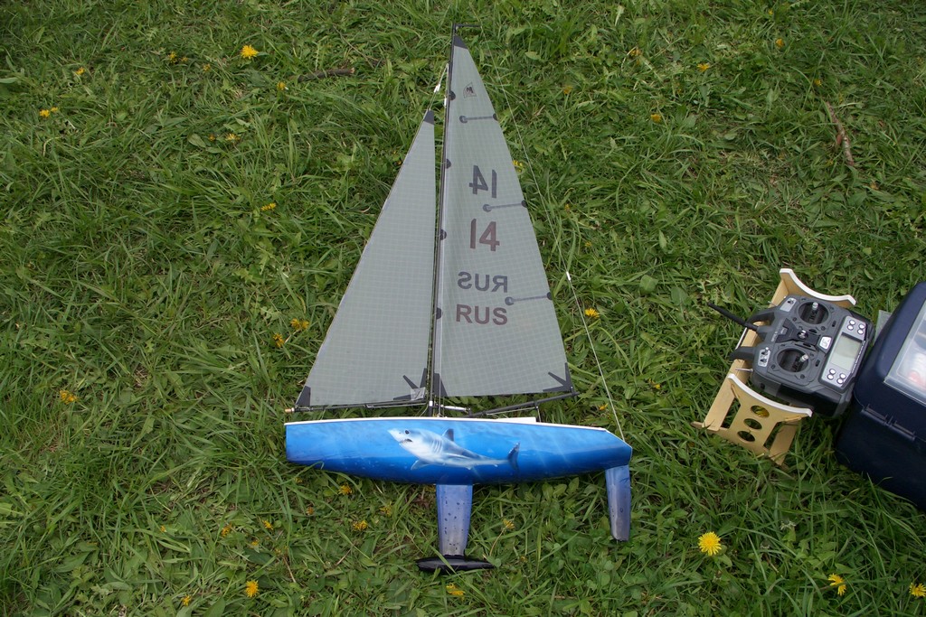

In the first phase of Zelenograd Regatta 2013 was a new boat.
Two of the rudder-like to you? Smile

Hi Vladimir,
nice, but maybe just for optical matters. From my experience it does not fit to the hull of a MM due to the only relativ small width of the stern part. Thus both ruders are in the water and the second will increase resistance as well as any ruder movement one ruder will counteract like a brake - overall will reduce speed and sail balance in this configuration.
If two rudders, than at least both should be reduced in size.
It would better fit to a modified hull shape like this just slightly modified cMM from Eric Lhoir (Hamburg) already back in 2003:

Hi, Thomas!
We talked to the owner is the same. Smile He said he still beat us all Smile
But as long as the result of weak - 8 out of 12.
